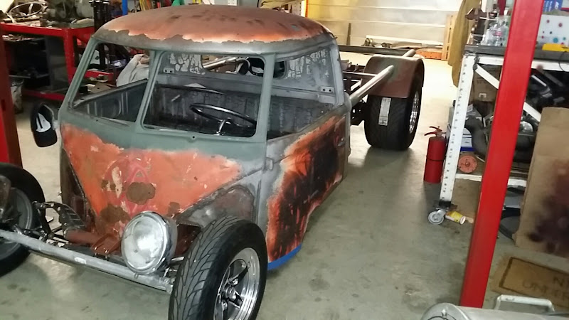

Finished framing in the bed, welding in the fenders and installed tail lights.

Thanks! Here is todays progress.
Started making paper templates for the bed sides, Welded in one of the lower bed rocker panels and incorporated a lower radiator mount.

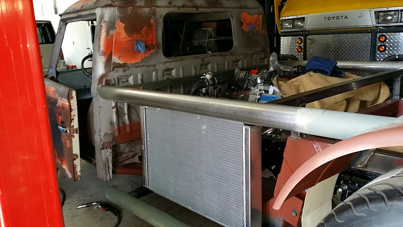

Installed the radiator today with a fabricated upper brace. Went to the parts store and got a handful of hoses that might work. All I had to do was bend up some 1 3/4" aluminized exhaust tubing to run from the water pump and under the engine to the radiator.
This bed side will need to be louvered are punched. There are two electric fans yet to be installed along with the a/c condenser.

Pedaalemmer 10-09-2015 13:41
Progress is looking good! love the build sofar. Are you going to install a side airscoop to allow direct airflow to the radiator?
Something like the Espace F1 station? :D:D

Thanks! I am trying to source some used factory vw bus engine vents. The engine compartment will also have a suction fan to draw the heat out.

The fans will blow air through the Radiators, or will the suck air through them?
Ben Modified 16-09-2015 10:45
They will suck air through. There is also a fan for the engine compartment itself, which will pull hot air out
