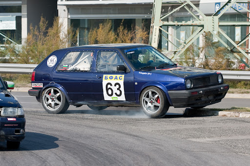

I made my rallye like that .

isnt it damaging the structural integrity?

It's possible of course but i think that they are strong enough . I know a person driving 300hp mk2 4x4 with holdex with the same set up and he has no problems. Even after this crash there was no damages on the hubs http://lh3.ggpht.com/_5ORsDn-Eq00/S...ck/IMG_3280.jpg (the brake disk was broken).
