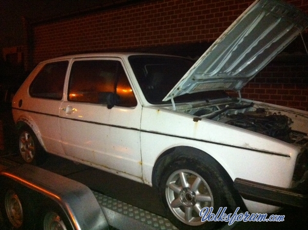

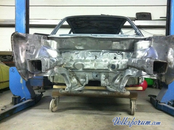

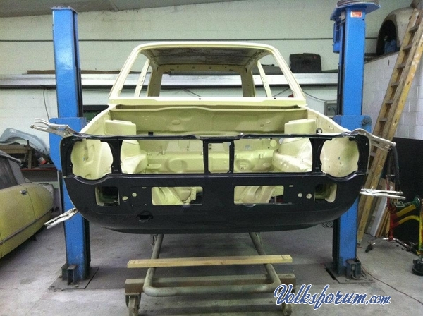

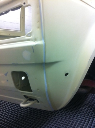

hier enkele foto's heb grote selectie moeten maken maar ga jullie beetje op de hoogte proberen te houden:
GTI BIJ AANKOMST:
[IMG]
[/IMG]

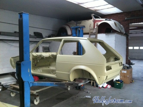

AL HEEL WAT LATER VOLLEDIG GEDEMONTEERD:
[IMG]
[/IMG]

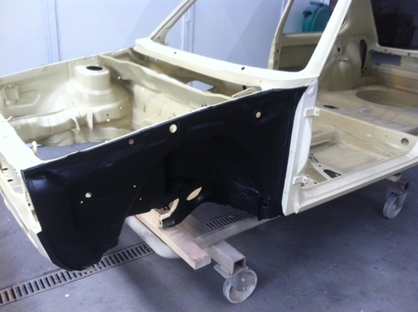

WIELBOGEN GEZANDSTRAALD VOLLEDIG GESCHUURD EN EEN HARDE EPOXY LAAG ER OP:
[IMG]
[/IMG]

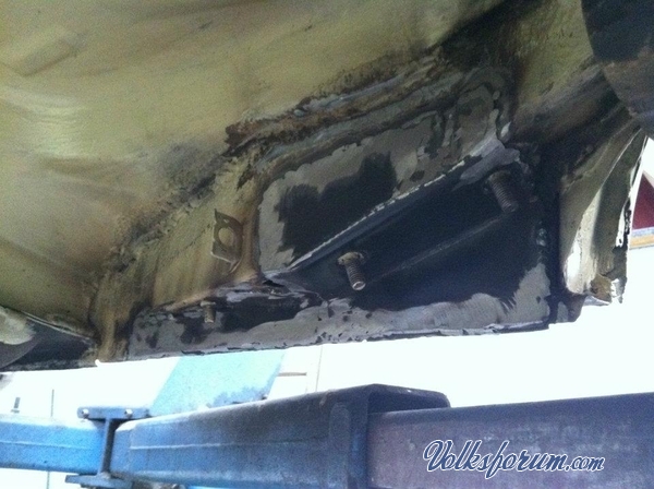

HOEKJES WAAR ACHTERAS AAN BEVESTIGD IS VERNIEUWD:
[IMG]
[/IMG]
ALLE ROESTE STUKKEN ER UIT GEHAALD WAAR ZE DOORGEROEST WAREN:
[IMG]
[/IMG]
WIELBOGEN:
[IMG]
[/IMG]
[IMG]
[/IMG]
[IMG]
[/IMG]

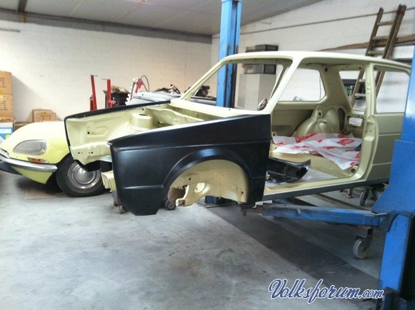

NIEUWE SPATBORDEN EN NIEUW FRONT:
[IMG]
[/IMG]
[IMG]
[/IMG]
[IMG]
[/IMG]
EPOXY LAAG OPNIEUW GESCHEURD EN GEPLAMUURD OP EPOXY:
[IMG]
[/IMG]
DAARNA OPNIEUW EPOXY ZODAT PLAMUUR LATER NOOIT MEER KAN INZAKKEN EN EVENTUEELE KLEINE KRASSEN KAN DOORTEKENEN IN DE LAK EN NIEUWE ORIGINELE MOTORKAP:
[IMG]
[/IMG]
[IMG]
[/IMG]
NIEUW TANKHULSJE:
[IMG]
[/IMG]

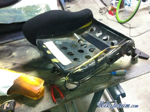

INTERIEUR AANPAKKEN:
[IMG]
[/IMG]
[IMG]
[/IMG]

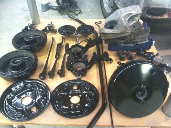

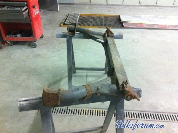

ACHTERAS:
[IMG]
[/IMG]
TERUG IN EPOXY:
[IMG]
[/IMG]
GELAKT:
[IMG]
[/IMG]

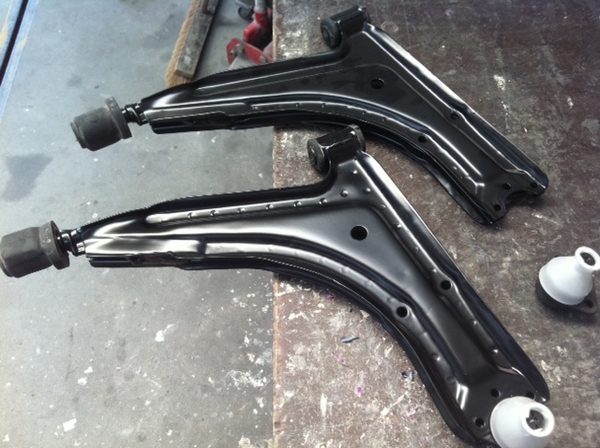

TRIANGELS:
[IMG]
[/IMG]
[IMG]
[/IMG]
NADEN MET MULTIPROTECT TERUG DICHTMAKEN:
[IMG]
[/IMG]
STEENSLAG SPUITEN:
[IMG]
[/IMG]
MET NADENKIT ALLES DICHTEN:
[IMG]
[/IMG]
[IMG]
[/IMG]

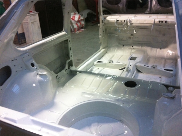

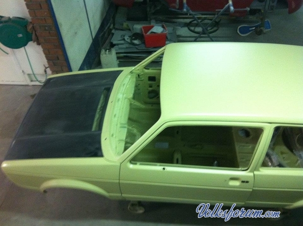

BINNENKANT AL IN DEFINITIEVE KLEUR:
[IMG]
[/IMG]
[IMG]
[/IMG]

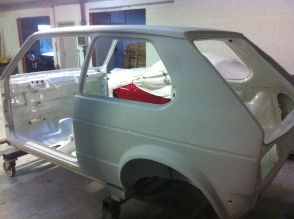

BUITENKANT NOG IN GRONDLAK:
[IMG]
[/IMG]
dit is zowat waar ik nu zit word vervolgd
