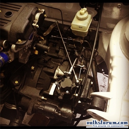

Fitted clutch cable assembly and 02A shift rods. Real %&*# to set up though!

more info on that shiftgear please?
never seen before.....

it's a kit by Grasshopper Drag (Claus von Essen) which uses some mk1 5speed parts and the original shifterbox. Shifts a lot tighter than the 02A cablebox

Engine bay looks already very nice, what kind of clutch cable are you using and where did you get it from.
if i compare the length of my mk1 o2a clutch cable from htt and yours.
there a big difference in length, yours is longer.
and is the end connected to the gearbox bracket at the end facing towards the rearend of the car.
i also notice that you cut and rewelded the up and down moving lever.
to aling the bended stainless arm with the balljoint connected to the above mentoined lever.

clutch cable is from a mk2 1300. The lever on the gearboxtower you mean? Yeah, you have to bend that one.

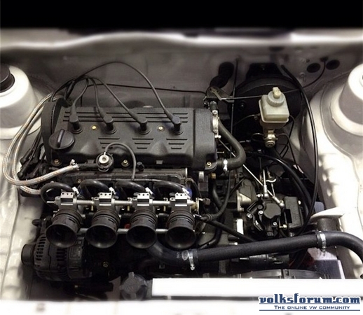

So this is where i'm at right now:
Still got to make a couple of brackets (coilpack, throttlecable, etc), weld an exhaust system (from the Sharan VR6 parts) and make an engine and interior (84 fusebox to 77 dash) wiring loom.

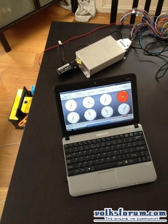

Took me some time to set up, but made my Megasquirt setup wireless with bluetooth
