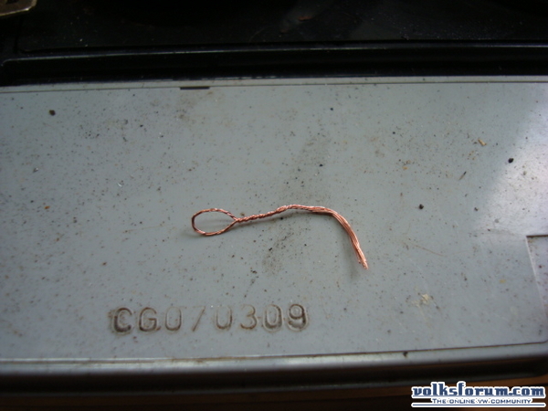

Strip a wire for 5cm.
Take 3 strands of the wire and twist them up.
Make a lasso out of the twisted wires, bend the end 90 degrees, wich makes a noose out of it.
Put the two wires together and tie them up with the noose until they are firmly together,
if the wires are hard to get into this position, use 2.

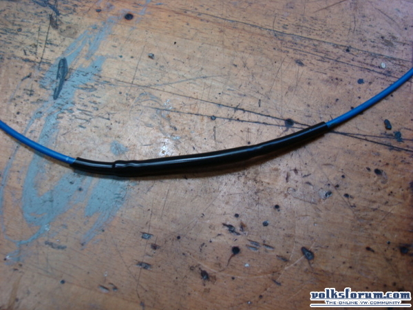

In a loom this is the best way to finish your connection; heat shrink. In places were there is severe mechanical rubbing or shaving you can add self fusing tape.
That is a non-sticking tape, that fuses together into one layer of rubber. Gives good mechanical strength and protection. Available in different sizes, colors and from multiple brands.

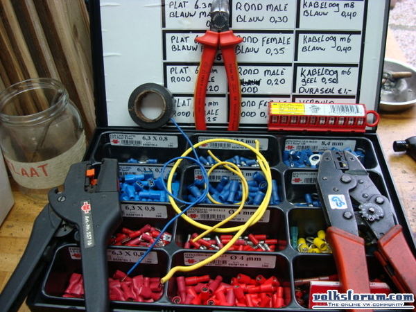

Roughly, this is what you need:
Wire stripper, wire cutter, crimping tool, crimp connectors (or AMP's)
Extra's: digit tape, insulation tape, heat shrink
The samples used are 0.75mm2, 1.5mm2 and 4mm2, commonly used in cars.

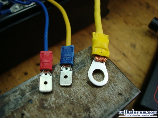

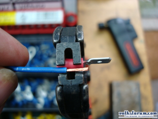

The subject of tonight; the connectors. On the left the model of a manufacturer who clearly got the message, made of aluminium, with a barrier installed to point out how far the wire should be inserted. On the right a cheaper model with a harder plastic as insulation, made of tinned copper and without a barrier. Both models are up to the job, but there is a difference in price and durability
Strip down a wire +/- 10mm and try the application, some connectors need more, some less. As the wire is stripped, you do NOT touch it anymore, no twisting up the strands etc. Twisting it up will cause the connector to have less grip on it and the connection will be less dureable. The wire that i am using here is the absolute minimun for this connector; 0.75mm2. Roughly said half the max wire thickess can go in a connector; max wire thicknesses are - red 1.5mm2 / blue 2.5mm2 / yellow 4mm2 (AWG18 / AWG15 / AWG11)
The crimping tool; good to see here that this is a double pinching tool, one for the insulation, one for the wire. Tools that only pinch one time and require two seperate pinches are absolutly unsuitable for a good connection

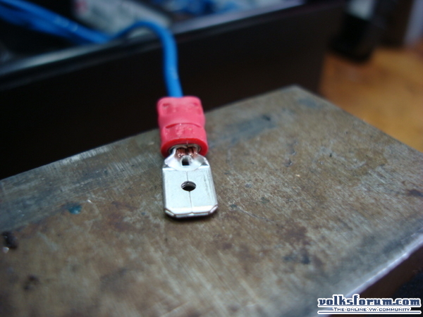

Crimp the connector and here is the result above, shaped as a half infinity sign, with max contact between wire and connector.
3 examples of crimped connectors, the tool visibly leaving a mark on the insulation, you know it was done right

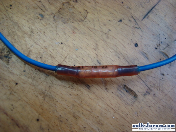

Sometimes, escpecially on oldtimers, the copper of a wire can see totally blacked out, no solder will flow and no other means of connection are possible, that is when i turn to this connector:
My supplier calls this the "duraseal" and no they are not cheap...in basic it's a standard connect-through item, but the shell has a suprise to it...
The proces of use is the same, strip the wire, insert both sides and crimp, nothing fancy so far, but then you take a torch or paint stripper and heat it from the middle section outwards.
Inside the tube, that is actually a firm heat shrink, is an amount of wax that is released as the tube shrinks
You keep heating until the tube is shrunk all the way and wax comes out both sides of it,
the connection is now waterproof and ready to go.

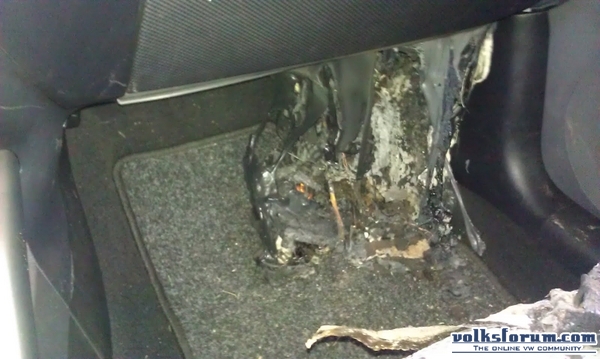

Beware that although the voltages in a car are low and seem safe, a fire is started in a blink of an eye and not just the old cars suffer those problems, a dutch forum member found his young Seat with a burnt out dash one morning;
The extra electric heater had commited an act of self combustion and although the 40A fuse popped out,
the car's dash burnt out....
The result was a total-loss
