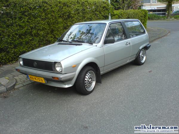

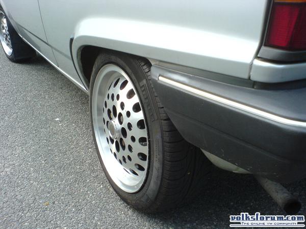

Summer arrived, and I finally sourced tyres to fit these NOS Centra Pepperpots: 175/50 R14 Pirelli P6000 on 6J-R14-ET48.
As you can see, it's not lowerred at the front.. but it's hanging to the back.. Did I only lower the rear? Nope. It's allready having it's new engine lying around in the back..

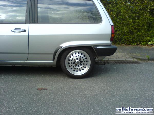

As it's kind-off a daily beater, things do need maintenance. Things tend to break.. like shock absorbers. And as it is a beater, on a tight budget.. I had to swap the complete suspension to -60mm.. as that's what I got laying around.. horrific.
Doesn't look that low, but trust me: it's satisfactory to me The rearwheels are allmost completely within the arches:
Will go nicely with the 14" summer rimms.
